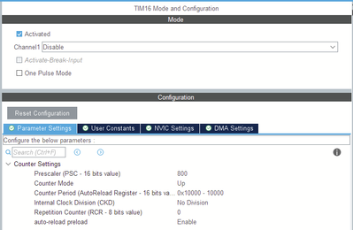

2025-10-06 2:11 PM - edited 2025-10-07 9:32 AM
@TDK wrote:When you start the timer, set its counter to 0 first.
It's an up-counter, and so what I actually want to do is set it to -10000. When I do that it works well. That raises a (perhaps even stranger) question: why is the following not successful?
__HAL_TIM_SET_COUNTER(htim, __HAL_TIM_GET_AUTORELOAD(htim);When I check the value of __HAL_TIM_GET_AUTORELOAD I see 65527, which is neither 0x1_0000 - 10000 nor 0x1_0000_0000 - 10000; so I don't know where it's coming from. My mistake; configuration de-sync issue.

2025-10-07 10:25 AM
You wrote "0x10000 - 10000" in the MX UI. This is an unsigned value equal to 55536, so that's what it uses. You're not writing a negative value.
