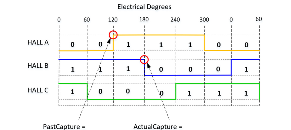

I want to measure the time period between each hall state

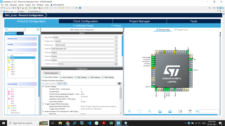

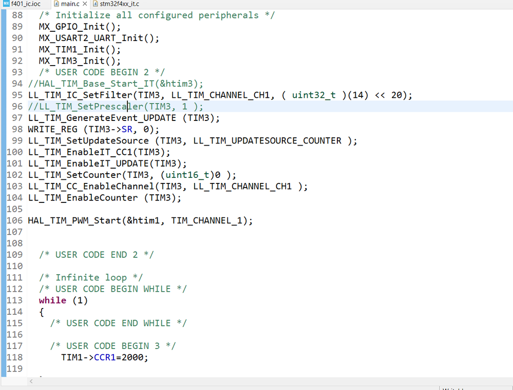

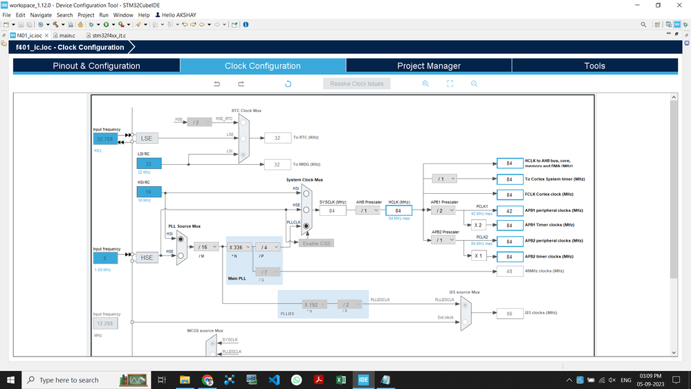

I configured timer 3 in XORmode so that every change in hall state interrupt will occur, based on this i implemented this code but the period measurement is incorrect.
comment for discussion, please feel free to ask questions to solve issue
code for period measurement
