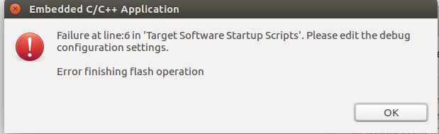

I am using STM32F777IITx MCU based custom board with STM32CubeMx v4.24.
I want to built a application where i want to Read/Write data from/to flash.
I am have written a small application where i write 10 bytes of data to flash and also read those 10 bytes from flash
My code Complies properly with no errors, However, when i tried to run the code in Debug mode i am getting the error mentioned below.
Whereas i have not changed anything in the Startup script, also i have attached the startup script below

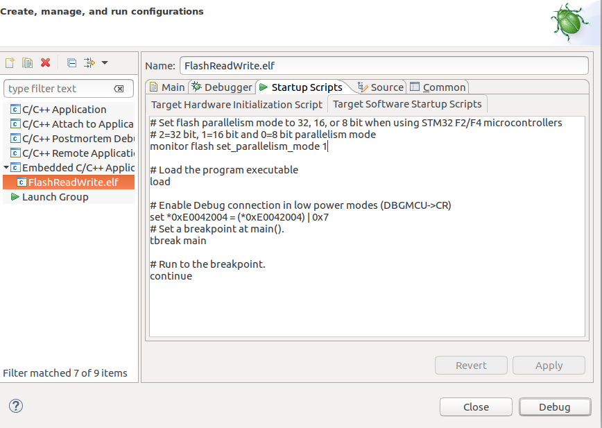

# Set flash parallelism mode to 32, 16, or 8 bit when using STM32 F2/F4 microcontrollers
# 2=32 bit, 1=16 bit and 0=8 bit parallelism mode
monitor flash set_parallelism_mode 2
# Load the program executable
load
# Enable Debug connection in low power modes (DBGMCU->CR)
set *0xE0042004 = (*0xE0042004) | 0x7
# Set a breakpoint at main().
tbreak main
# Run to the breakpoint.
continueSo please help me to get rid of this issue at the earliest and if i am making any mistake while debugging please help me with it ,
Also if there are changes to be made in startup script please help me with correct startup script

2019-10-10 9:09 PM
Hello Pavel,
Thank you for the response,
I Changed the parallelism mode to 1 and tried to debug however still facing the same issue with same error pop-up as mentioned in last post.
I have attached the screen shot of startup Script please check.

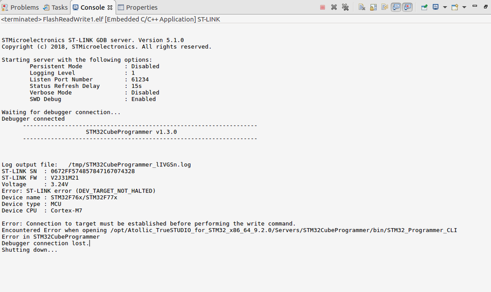

2019-10-11 5:10 PM
It looks like some error occurs in the "load" command.
Please open the Debugger console window and see what it says there.
(the output should begin with "STMicroelectronics ST-LINK GDB server" .... )
-- pa
2019-10-11 9:47 PM
Hello Pavel,
Thank you for the Response,
I have attached the error message on the console, however i am not getting anything like "the output should begin with "STMicroelectronics ST-LINK GDB server....." .
ERROR MESSAGE:
Error: Connection to target must be established before performing the write command.
Encountered Error when opening /opt/Atollic_TrueSTUDIO_for_STM32_x86_64_9.2.0/Servers/STM32CubeProgrammer/bin/STM32_Programmer_CLI
Error in STM32CubeProgrammer
Debugger connection lost.
Shutting down...
Please check the error and help at the earliest its urgent
