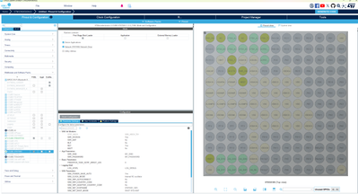

As you can see I am trying to move the free Rtos and x-cube-st67w611 middle ware from the application context to the FSBL context, I am using the stm32n6 mcu series and MX 6.16.0 version.
I failed to see the full message suggested by the MX tool, as to why this is, I also noticed that in the example projects the context is fixed to FSBL, hence doable. my intention is to develop in the FSBL content and latter migrate to the application content.

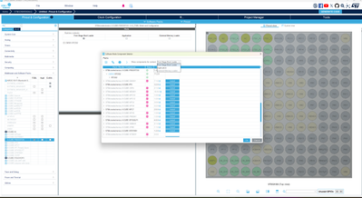

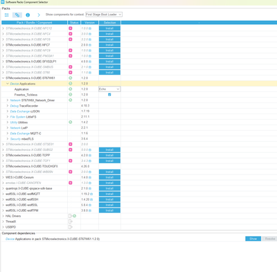

All you need to do is go to the Software Pack and, in Show components for context, select First Stage Boot Loader.
You will get this
