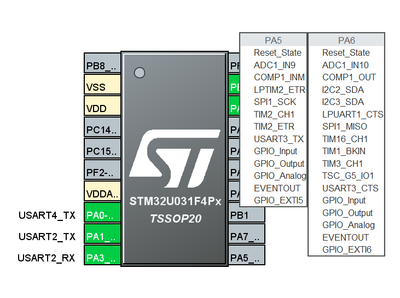

2026-02-16 8:03 AM
I just created the project in freshly installed cubemx, and pushed the pin... the 2 other IO pin connections do not pop up...
I have now tried to enable USART, seems not to change anything...
For pin PA5 it seems to work ok to show more IO:

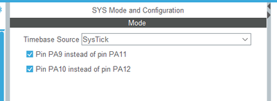

Hello @KJeps.3
To use the alternate functions of PA9 and PA10, you can use the remapping option under SYS as follows:
As it is possible to use PA9 instead of PA11 and PA10 instead of PA12. (you can use USART1_TX with pin15)
For Pin14 I will check internally with dedicated team to investigate the missing of the other function.
KR, Souhaib
