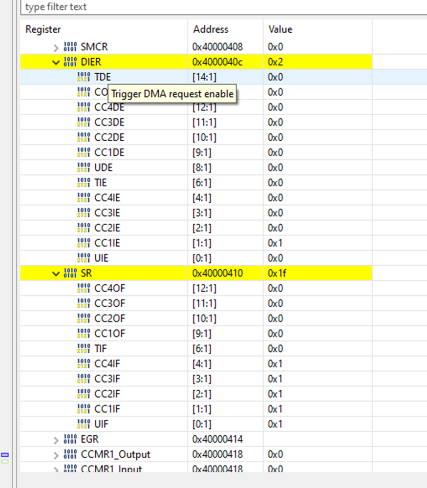

2023-01-02 7:52 AM
If you want to see the flags being cleared, the respective DBGMCU_APB1FZR1 bit to stop timer while debugging, otherwise it will keep running and setting the flags faster than the debugger succeeds to read it out.
The flags in SR are set regardless of whether respective interrupt in DIER is enabled or not. If you want the ISR to handle only the enabled interrupt, you must check which interrupt is enabled and act accordingly. The simplest way is to mask SR with content of DIER (note that position of respective flags matches the bits in DIER, it's no coincidence, it's deliberately designed so this operation can be done easily).

2023-01-02 1:18 PM
So at this end I am hearing you say (The simplest way is to mask SR with content of DIER (note that position of respective flags matches the bits in DIER)
if (htim3.Instance->SR & htim3.Instance->DIER)How do you handle if both the CC1IE and UIE are enabled? You still have to check flags, doesn't it make more sense to do what I did above in the picture?

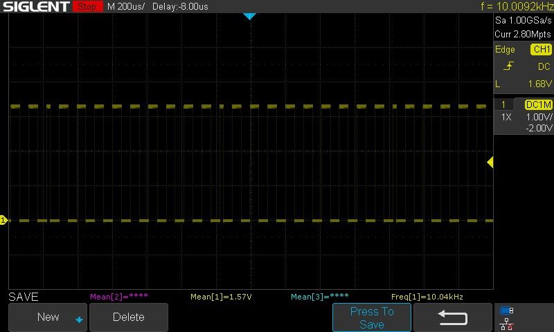

2023-01-02 3:28 PM
I have attached a very basic test that just isn't working as I would expect. Can someone tell me what I am missing here???? I have reduced the code to 20MHz on APB1, using Timer3, pre-scaler set to 0, period set to 20000 - 1...effectively the clock is 20MHz with an interrupt being generated at 1ms (20000/20MHz). I have programmed the CCR1 register with 1000. This SHOULD give an interrupt every 50us as the compare register only cares about the counter NOT the period setting (20000 - 1). Now what I care about is a "consistent and reliable compare output". I don't care about the 1ms interrupt. Below shows the code as well as a scope image. Notice that every 10th pulse is shorter than the other pulses. The UIE bit is NOT set AND the condition in the ISR should never get encountered when UIF goes off every 1ms, BUT as you can see the UIF flag going off toggles the pin and causes a jittery 10th pulse ie 1ms (20000 / 20MHz). If I change the period to 10000 -1 the jittery pulse moves to 5 apart instead of 10 which just supports that the UIF flag is causing this. How come I cannot get these pulses from STM32 product to be this precise??? (beyond frustrated)....This is as bare bones code as I can do and it still is NOT working....Scope says it all.
Notice ONLY CC1IE enabled.

2023-01-02 9:11 PM
> htim3.Instance->CCR1 = htim3.Instance->CNT + 1000;
This does not result in interrupts exactly 1000 clocks apart. CNT keeps counting after the compare happens, so the next CCR1 includes interrupt latency and execution time, so the second CCR1 will be something like 2050, the third 3100, etc.
And when CCRx>ARR, compare thus interrupt happens at Update.
PS. note that if you have other, higher or same priority, interrupts in your system, interrupt latency may increase dramatically
2023-01-03 6:17 AM
Thank you very much for the insight! I really appreciate it.....What I cannot get my head around is that first I am doing nothing else (no other peripherals other than the serial wire debug) is being done....Nothing configured and while loop is empty....My system clock has been slowed to 20MHz....I don't see how it is possible that going into an interrupt reading a counter (bare metal) and adding 1000 clock cycles wouldn't be slow enough for the processor to accurately do...I can do this all day in an MSP430 and never miss a beat at 20MHz...I purposely slowed things down and enlarged the count value to test this.
There must be something that can guarantee exact timing?? This would be absolutely useless if you wanted to take consistent continuous A/Ds for FFT work........
I have no other interrupts in the system.....Is there a way to push up my priority (my understanding is 0 is the highest) or increase CCR1 OVER UID?.....

2023-01-03 7:08 AM
As you suggested earlier CCR > ARR....
below code is getting me closer....still a little jitter

2023-01-03 7:24 AM
Thank YOU so much for your help....The following code is jitter free and looks great!!!!

2023-01-03 8:00 AM
> uint32_t temp = htim3.Instance->CNT;
Note, that you are still basing your calculation on the CNT, which is counting thus subject to interrupt latency plus execution time from ISR beginning to the point of readout. If you measure precisely, you'll see distance between edges somewhat larger than 1000 counts, maybe 1050 or so.
For precise calculation you would need to advance the CCRx, so it changes as 1000-2000-3000 etc.
Also a minor correction at the rollover: note, that after ARR comes 0, so you want your formula for the (tmp + 1000) > ARR to be (tmp + 1000 - ARR - 1).
2023-01-03 9:13 AM
The real trick here I realized is that in the MSP world I traditionally let the counter roll over at max count in which case when a value is added to CCR if it is larger than 16 bits it just wraps around nicely and all is well. I am sure if I placed a max count on the counter in the MSP world I would have the same issue. In STM world with higher clocks and 32 bit registers I guess I was thinking of limiting the max count.
