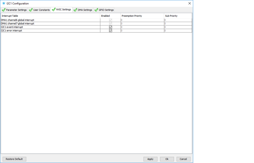

NB: I have found a post related to my issue - https://community.st.com/s/feed/0D50X00009XkVw0SAF
but still confused... In my CubeMX I2C interrupts are enabled (see below):
and my FW is stacked after HAL_I2C_Mem_Read_DMA() call...

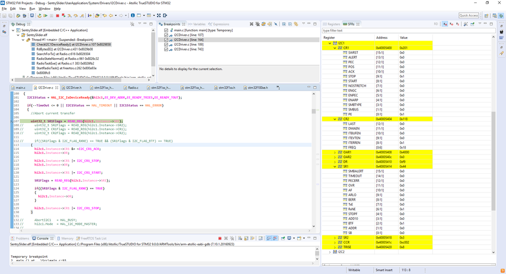

RE: The result of my debugging:
The execution of HAL_I2C_IsDeviceReady() ALWAYS returns HAL_BUSY although I2C_WaitOnFlagUntilTimeout() ALWAYS returns HAL_TIMEOUT!!!
(see attached I2C Debug.docx)
Re: New event captured (see attached file).

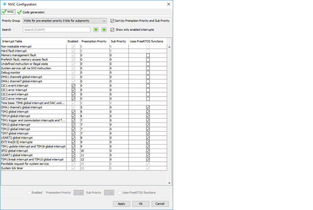

Re: I have increased the priority of I2C and relevant DMA interrupts to the absolute maximum level of 0 (see attached screenshots).
FreeRTOS still works fine. BUT…. Same event as described in the doc file yesterday happened…
RE: I am trying to resolve my I2C issue by experimenting with some abort communication code (see attached picture). I assume that the closing of I2C communication by the Master (MCU) is not done correctly in some cases when I2C interrupts are not the only ones with highest priority.

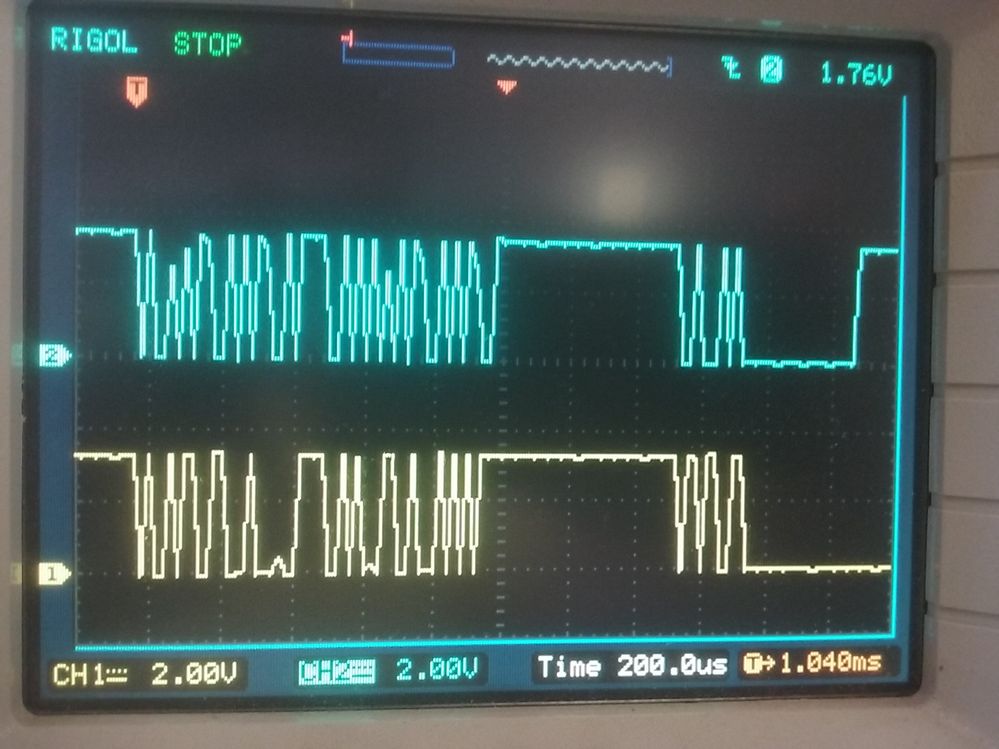

I have caught another event displayed on the pictures below:
Surprisingly it looks like the current byte read is interrupted after just 3 bits been read (well, my scope resolution is quite poor)! ITERREN flag is set, but my I2C error interrupt service routine break-point is not hit! I have NO reasonable explanation whatsoever!
What could that be?
