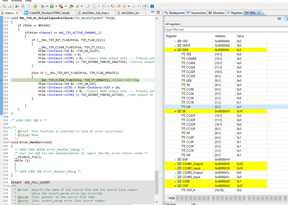

I have breakpoints right within the ISR Callback on the line that should clear the flag. I step over this and the state of the flag doesn't clear. I've set the break on both the HAL and the register line and neither do the job.

You step over this, and the flag clears the it sets again in 100 us. You cant's see it cleared.
Using &= means "clear the selected flag and all other flags set during the execution of this statement". It's not what you want - you may write more than one 0 to the SR this way.

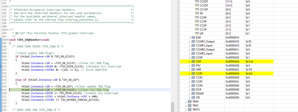

I have a SystemClk of 80MHz, an AHB1 clock of 20MHz, a TIM3 divisor of 4 and the counter period set to 500....Effectively giving me an UIF every 10kHz. I was able to get code working by deleting the HAL callback within TIM3_IRQHandler and write my own....I've written my own function within the IRQ and it is working....below is a snapshot of code (with 2 breakpoints and registers) I do have some questions....
I understand breakpoints can be tricky especially within ISR but if the IDE isn't yielding accurate results how can you troubleshoot using it??? I have the Compiler optimizations set to None and Debugger set to Maximum.
