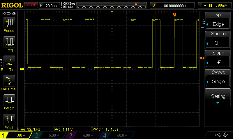

On closer inspection, it appears the LSE oscillator isn't so healthy after all. Running the otherwise unmodified CubeMx project (previously attached) on our board produces a very unstable, glitchy clock. I switched to a NUCLEO-L452RE board (closest I have) with an identically-configured CubeMx build, and got the same result (measured at RCC_LSCO):

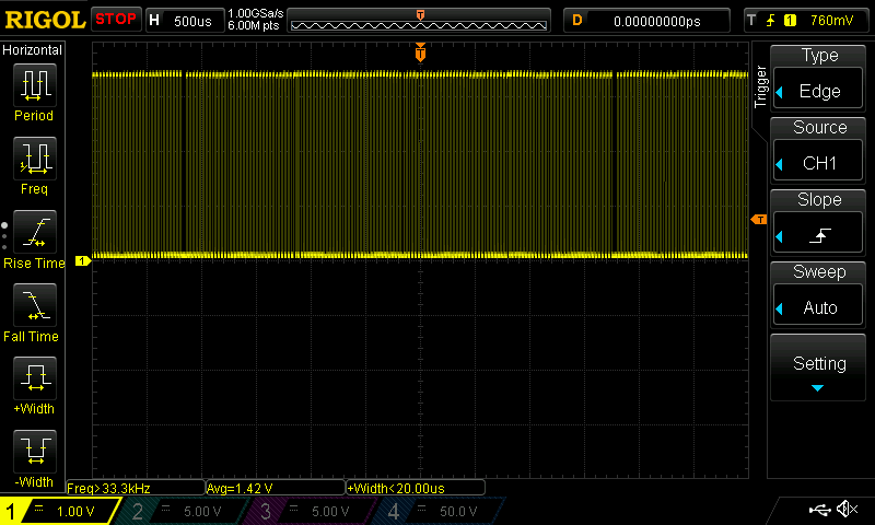

Zooming out, there are missing clock pulses roughly every 4ms or so:

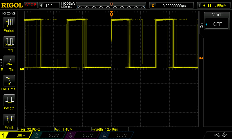

Touching the oscillator causes even more erratic behavior. Breathing on either our custom board, or the NUCLEO board, causes oscillation to stop entirely; it re-starts once the area has cooled. It seems the HSE is barely at the precipice of stability. Applying a bit of cryo-spray to the LSE area of the NUCLEO board does not visibly improve stability.
