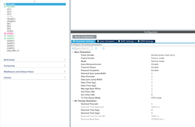

FDCAN1 configuration:

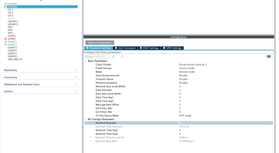

FDCAN2 configuration (noting that the prescaler is 8, while the clock divider is 1):
with this configuration, FDCAN2 transmission works as expected (verified using a PEAK CAN dongle) at 250kbaud when I am running it on its own in normal operation -- started the FDCAN2 peripheral using HAL_FDCAN_Start(&hfdcan2). However, if I also start FDCAN1, then I can no longer read any transmissions from my CAN dongle.

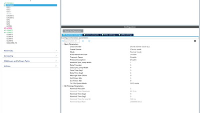

After unsuccessfully attempting to debug the issue in firmware, probing my CAN lines revealed that FDCAN2 was operating at 30kbuad (250k/8 = 30k). Going back at the CubeMX configuration, I tried changing the nominal prescaler from 8 -> 1:
Thankfully, this was able to resolve my issue, and FDCAN2 resumed normal operation at 250kbaud.
