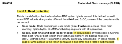

It's not possible to do the last step. You can't run flash in RDP 1 in debug mode. The chip needs to boot up normally.

One clarification to keep in mind regarding RDP 1, if boot is from flash and your bootloader is @0x08000000, it should run normally (in user mode) => It's valid to set RDP to 1 at the end of the sequence, just make sure you're booting from flash and not system memory or SRAM.
