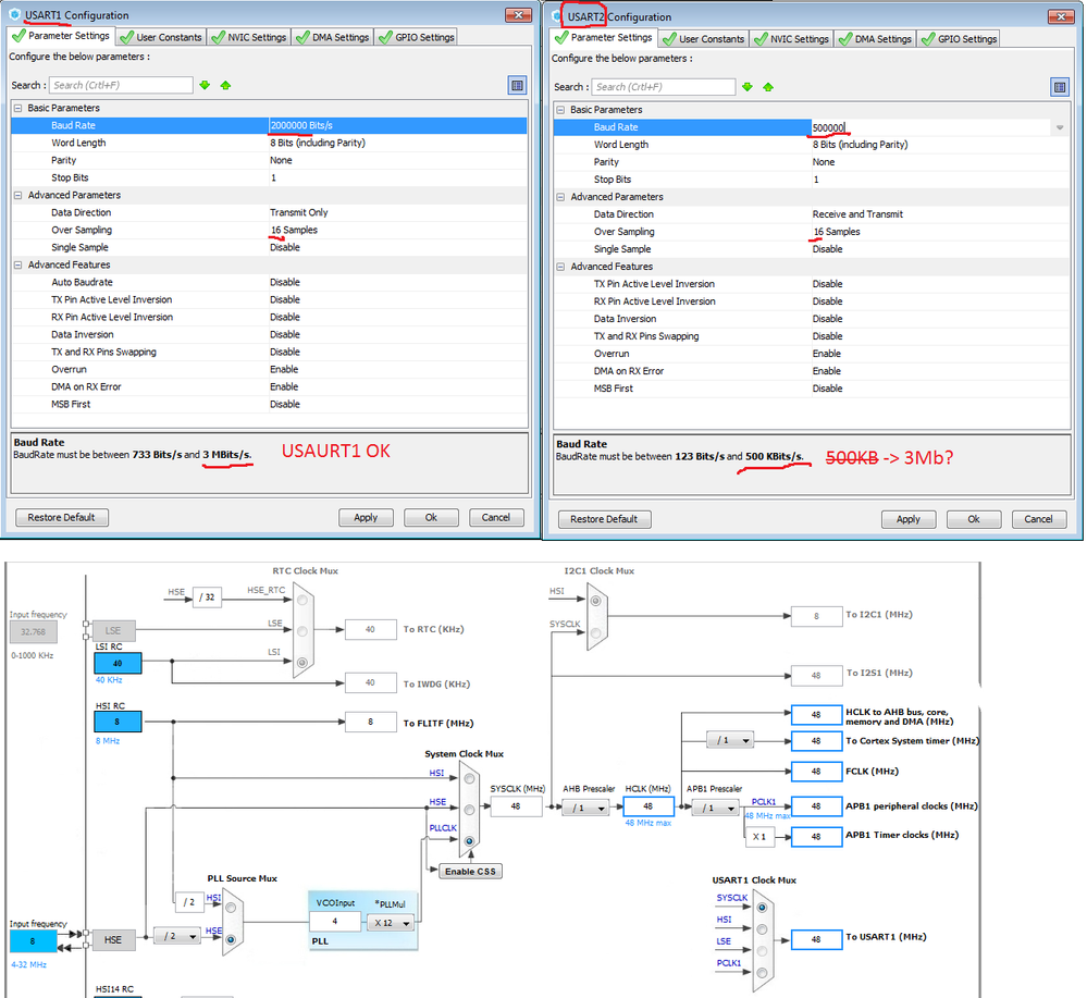

My name is Alef, I'm trying to set up the usart2 baudRate from STM32F030C8 to 2Mbps but I can not succeed.
I'm using 48MHz clock so according to the manual, at 16 samples, I should be able to reach up to 3Mbps, but CubeMx says the limit is 500kbps. But if I go in code and manually put 2000000 it seems to work normally.

This is an issuein CubeMX. In fact, as you said,
the maximum value of Baud Rate should be 3 MBits/s in case of 16 samples and 6 MBits/s in case of 8 samples.It will be fixed next release.
