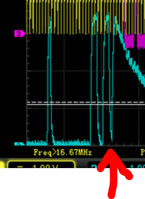

-error pattern:
At "read_cmd53" the 3V3-Signallevel breaks down in SDIO-Command-Line.
the "read_cmd53"-Command fails...
see this:

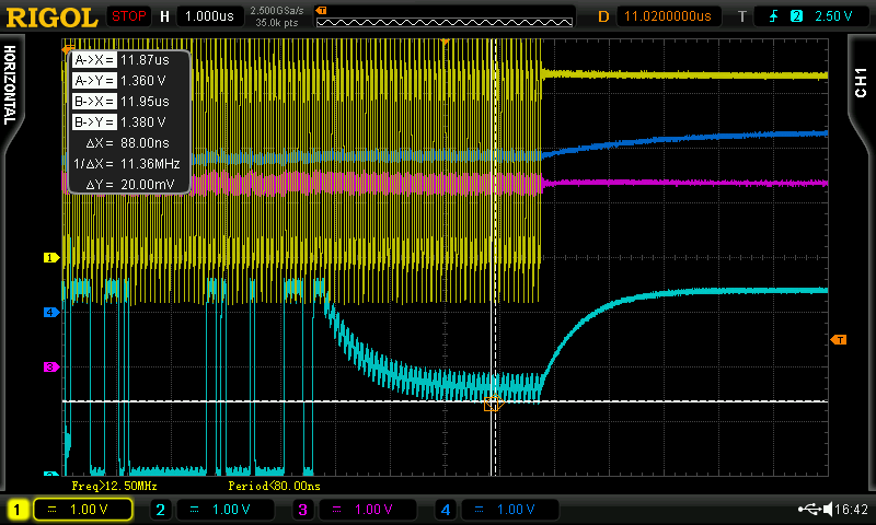

This Application runs fine on a Nucleo-STM32F429.
(with the exactly same Hardware !!!)

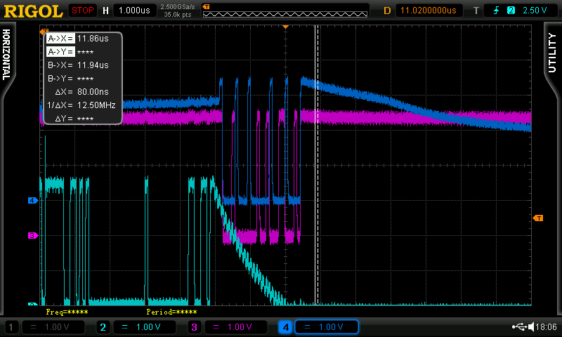

Here you can see, the Read-Data from Target will never send. (with 10k Pullup in CMD-Line)

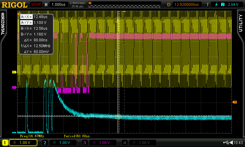

This is when I used the Onboard-Pullup (82k) on the Target-Board in parallel with the STM32-Pull-ups. (approx. 40k)
The CMD-Line (light blue) breaks down immediately, the D0-Line (dark blue) and D1-Line (lilac) are not stable...
What's wrong here?

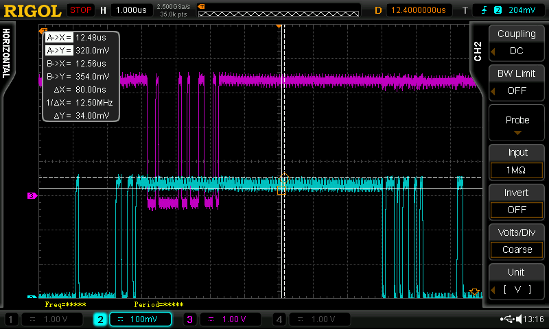

Again: Plug the Nucleo-F429 under the Target-HW -> perfect,
plug the Nucleo-H743 under the Target-HW -> chaotic signals.
The Setting for the GPIOS are GPIO_MODE_AF_PP / GPIO_PULLUP / GPIO_SPEED_FREQ_VERY_HIGH (same like F429)
To me, it looks like the Port-Supply (Port C/D) are not nailed to Vdd or something in the Supply is weak.
