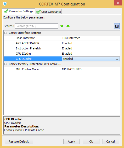

'The correct answer i was enabled D and I cache at the same time with accelerator, and it cause this.' ( this and accelerator ??)
when you have the ART Accelerator ON, D-Cache ON I-Cache ON, then .. what doesn't work ?
2017-08-03 6:38 AM
my external 32b SRAM interface does not work, while at the same time, debugger shows that every thing is ok.
It just does not want to generate any hardware signals, same code, commented DI init functions, and viola, works like a charm2017-08-03 7:06 AM
Or to be more precise, i can't use //SCB_EnableDCache();, since it will stop my SRAM interface working.
