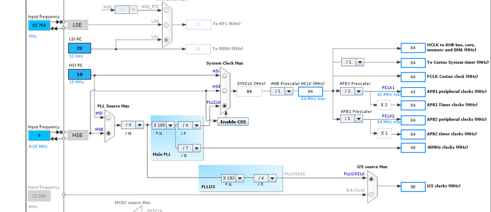

The 2kHz test signal, and the i2s-3 is set to 48kHz samplerate, but depending on how I configure the PLL, I hear 122Hz, 180Hz or 244Hz audio. I have confirmed with a logic analyzer that the I2S protocol runs too slow. The only things I have changed from the CubeMX generated template project is:In the source code, I only initialize the DAC and enable the DMA. No other changes to the generated source are done.
The three configurations I tried with:

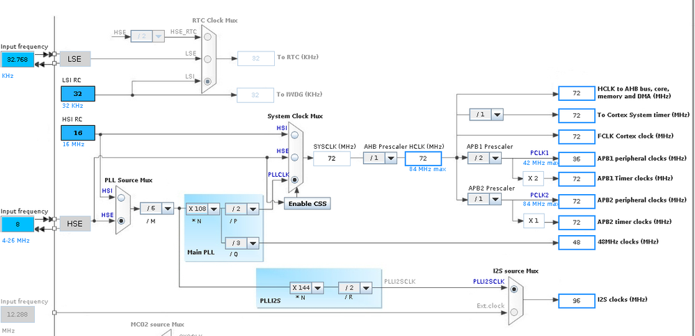

PLLM=4 gives a I2S WS (frame clock) of 2.93kHz, and the 2kHz audio is at 122Hz:With PLLM=6, I see a WS of 4.4kHz, and audio at 184Hz:

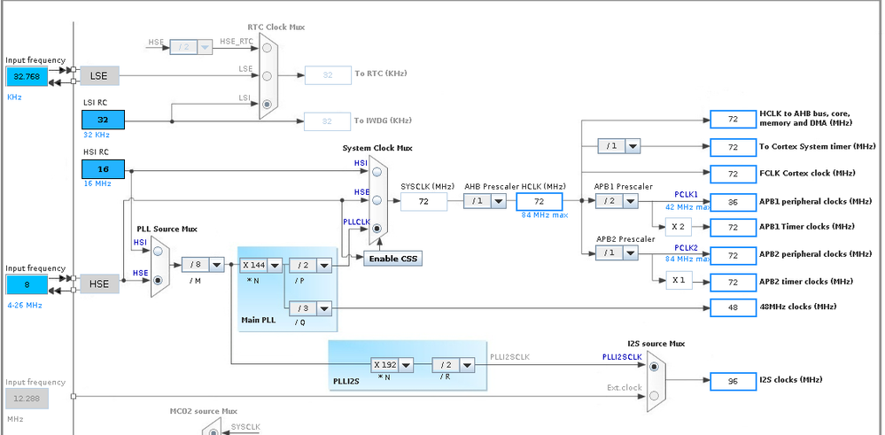

And with PLLM=8, WS is at 5.859kHz, and the audio at 244Hz:
