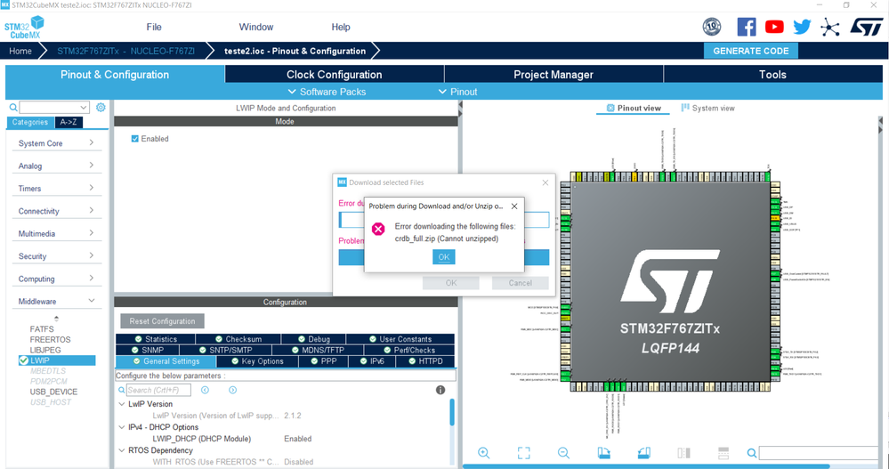

Hi everyone, I'm currently working with one NUCLEO-F767ZI board and everytime I create a new project on STM32CubeMX this "Error Downloading the following files: crdb_full.zip (Cannot unzipped)" appears.
I already tried to reinstall the STM32CubeMX and delete the crdb_full.zip file at <userfolder>\.stmcufinder\plugins\mcufinder\mcu\cs as suggested in another post.
I attempted unzipping the crdb_full.zip manually but it seems that there is an error with the file itself.
Is there any solutuion or workaround to solve this problem? Is this affecting the build?

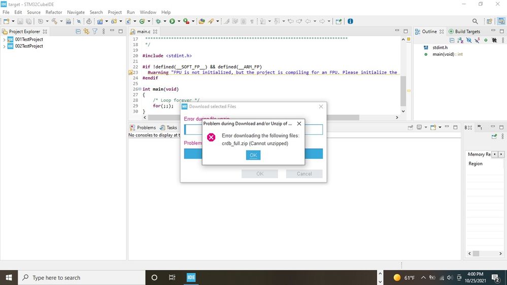

I face the same, so far unsolvable, issue: STM32CubeMX STM32F7- "Error Downloading the following files: crdb_full.zip (Cannot unzipped)"
I've just loaded 2 days ago STM32CubeIde 1.7.0. I've started an Udemy Tutorial and now I am stucked, can't progress. I spent more that 12 hours to consult documentation on how to fix. I failed to fix the issue. Please advice what to do. Thank you.
2021-10-25 6:13 AM
Additional info.-> This crdb_full.zip is in C:\Users\....\.stmcufinder\plugins\mcufinder\mcu\cs
( this contains: crdb.db, crdb.zip, crdb_full.zip - which is empty and can't open at all, not even manually)
-> in C:\ST\STM32CubeIDE_1.7.0\STM32CubeIDE\plugins\com.st.stm32cube.common.mx_6.3.0.202107141111\db\plugins\mcufinder\mcu\cs
exists only crdb.zip
I hope it helps.
