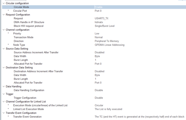

I'm using V6.15.0 of CubeMX with STM32U5 to generate DMA code. When I use the following configuration, it appears to generate incorrect code?
I've noticed the following:

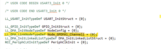

1) It placed the Node_GPDMA1_Channel1 structure on the stack:
This doesn't seem right, and I would note that when memory to memory DMA is selected, it allocates this (correctly) statically.

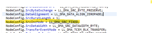

2) It sets the source increment mode to LL_DMA_SRC_FIXED:
This again doesn't seem right. When transferring from memory to peripheral, the source increment mode should be LL_DMA_SRC_INCREMENT.
