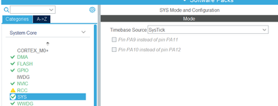

Could someone please explain the meaning of this image? It's a snapshot from CubeMX GPIO section.
Does it imply that PA12 and PA10 can be used as a single pin, or does it mean something else?

By default, those pins are PA11 and PA12. You can set them as PA9 and PA10 instead with these checkboxes:

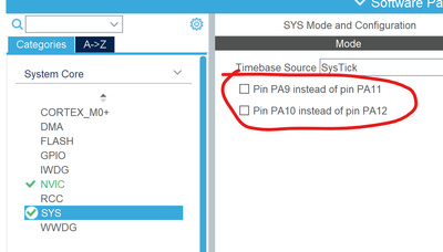

I have not clicked on the checkbox still my PA12 pin is not used as output I have tried toggling to this pin, to verify my toggling is Ok I selected another pin which works ok but when I am going to use PA12 The pin is not toggling You can see in my attached image
Also, if I try to click on the check boxes then I cannot be able to click it looks like these checkboxes are disabled
