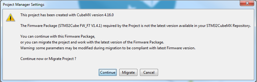

2017-03-28 6:12 AM
Hi Khouloud,
Isn't it a regression in CubeMX 4.20 because CubeMX 4.16 didn't have such a problem.
I'd appreciate If you could make the CubeMX compatible with older versions of FW_F7 as much as possible. Catching up with the latest version is not always an option, especially in developing firmware. Even a minor change requires a lot of testing as it may cause a timing problem or a crash.
If you don't have plan to support older versions of FW_F7, please provide us the link to download older versions of CubeMX. I've only found the link to download the latest version.
Hiroshi

2017-03-28 7:34 PM
Hi Khouloud,
Every version of CubeMX is dedicated to a specified firmware package versions.
OK. Then, will you provide the link to download older versions of CubeMX?
I've updated to 4.20 to prevent the nasty bug in 4.16. I'll try to find a version that works with
FW_F7 V1.4.1.
Hiroshi
2017-03-29 8:07 AM
Hi
Sakurai.Hiroshi
,The
STM32Cube FW_F7 V1.4.1 is only compatible with the CubeMX V4.0 and V4.1.
Sorry, but we provide only the last updated version of CubeMX.
Thanks for your understanding.
Khouloud.
2017-03-30 1:36 AM
Hi Khouloud,
Do you mean that there's no way to use CubeMX v4.16 anymore once you updated to CubeMX 4.20?
You don't understand what firmware development is.
If you provide only the latest version of CubeMX, the latest version should support older versions of FW. Or you shoud put a big warning on the download page which describes this pitfall.
I'm disappointed by the support which doesn't support a user.
2017-03-30 9:40 AM
Dear user,
Please find here the 4.16 version:
https://drive.google.com/open?id=0B3TGwFlypwI6NE5ncXVOV0ZpMjg
To avoid such situation, you may want to download CubeMX installations from st.com instead of the self-upgrade. This way you can keep both, your previously installed version and the newly released.
A 4.20.1 patch release will be delivered soon to fix 4.20 issues.
