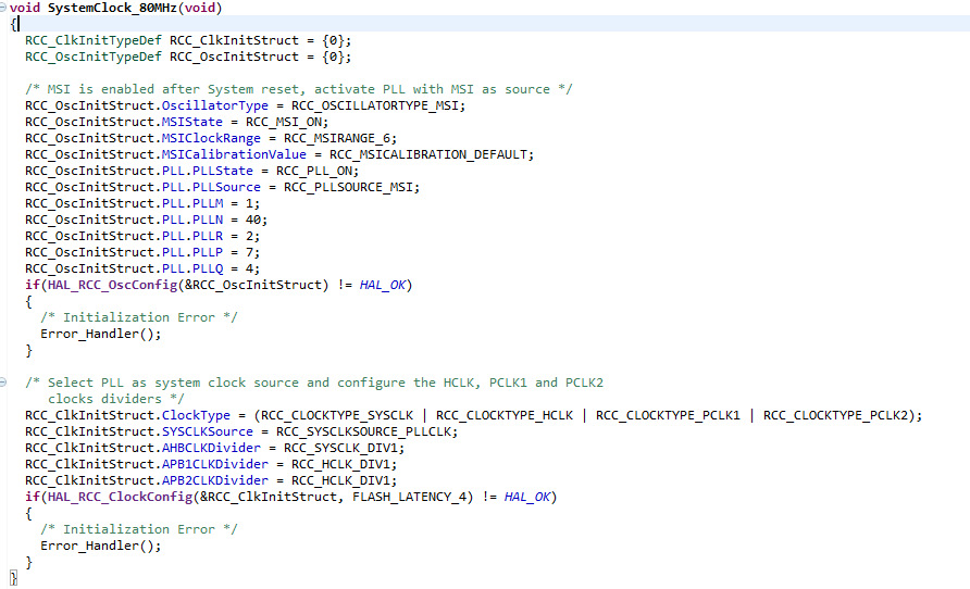

These are the below settings where working COM port:
Working example code:
CubeMX Generated code:
Where looked at the CubeMX generated code in SystemClock_Config
It uses the
 RCC_OscInitStruct.OscillatorType = RCC_OSCILLATORTYPE_HSE;
And the peripheral clock is also present.

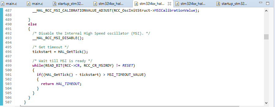

When i tired to debug the code which CubeMX generated, when it enters into the Debug mode, Target enters into the Halt state and
Waits for debug trigger to HAL_RCC_OscConfig
And prompt pauses at  499 line to READ the RCC and RCC_CR are at the Tick.
Thanks
Phanirajkiran
