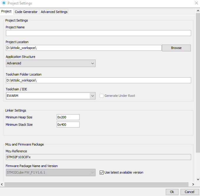

Hi, I notice that in "Settings" one can select in Application structure "Basic" or "Advanced". The first one erase src, the last one not erase src located in Core folder. Hope help someone. I use CubeMX v4.26.
