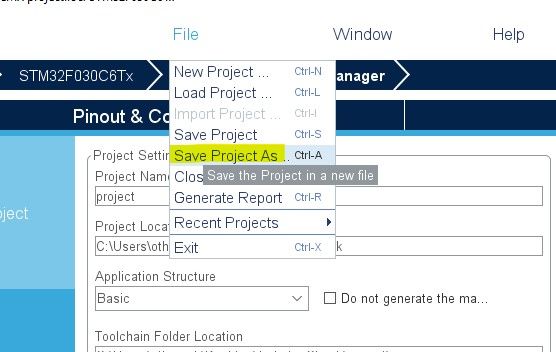

2021-02-19 9:14 AM
Hi. That option is disabled and can't be changed.
2021-02-19 9:25 AM
Yes, it will be disabled after the first generation.
The option can be available again, if you save the project using File > save as :
Then Application Structure can be changed.
