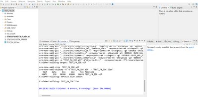

I have tried using STM32CubeMX 6.17.0 to generate an STM32F429 DISC1 project.

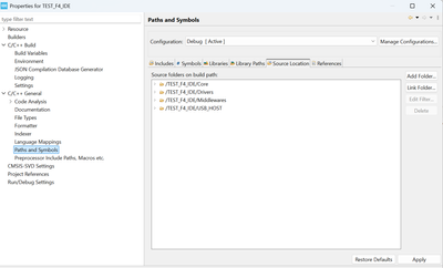

The generated project opened in STM32CubeIDE could not be compiled unless I add <root folder> in Project -> Properties -> C/C++ General -> Path and Symbols, the source location tab.
I don't know how this happen. It's disturbing to modify project settings each time after modifying the CubeMX and generating the project.
It's probably that should happened after I add some source folders to the projects.

2026-04-21 5:08 AM
Thank you for the try. I added some code to the project.
It seems sometimes it lost the root folder, while sometimes not.
Anyhow, I know how to handle this. If there are red errors, I add the root folder manually. That's OK.
