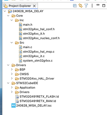

This is the folder structure:
What is missing from this workflow to create a project that can be built in STM32CubeIDE please?

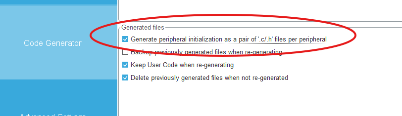

Additionally I recommend this setting:
This is easier with version control. Only peripherals that are changed will have changed files.

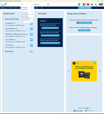

Try to open the .ioc using STM32CUbeMX following those steps:
- Launch STM32CubeMX 6.17.0
- Go to File > Load Project
- Browse to the project folder
- Select the required .ioc file
- Click Open
If the project opens correctly there, you can make your hardware/configuration changes in CubeMX, then regenerate the code with Toolchain / IDE = STM32CubeIDE

I now have the project toolchain specified as STM32CubeIDE, and the folder structure looks like this when imported into STM32CubeIDE:
I still don't have the ability to build the project, what is missing from the workflow please?

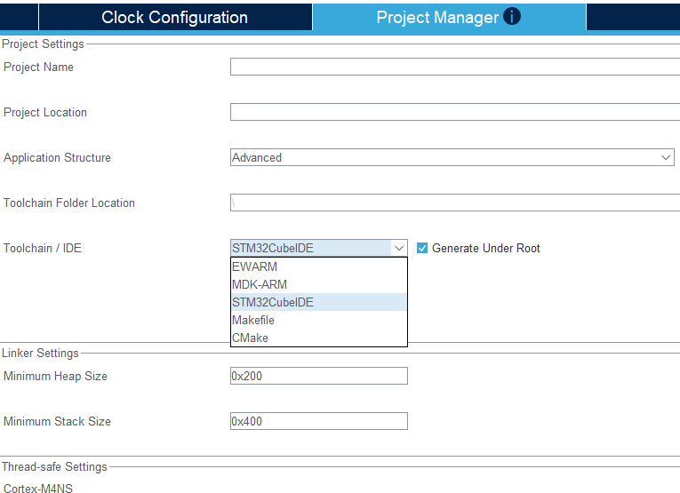

Should the 'Generate Under Root' option be ticked next to the Toolchain/IDE selection in STM32CubeMX please?

For the "Generate Under Root" option, please leave it unchecked.
