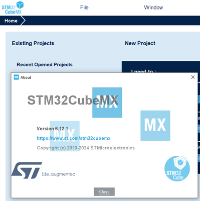

We are pleased to announce you that the minor release STM32CubeMX V6.12.1 is now available for download on st.com.

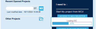

Strange situation that I created the new one. Worked with it and in the one time didn't open any menu as GPIO or System - no one.
Then I closed, open again - tried to open
loading and then nothing

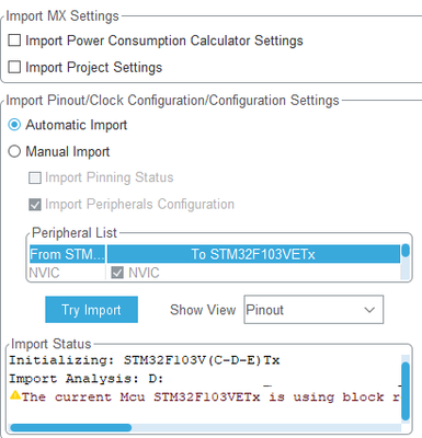

I tied to import my project to new project and see the exception with text: " The current Mcu STM32F103VETx is using block remap as a consequence Pinning status will be ignored" hmmm... What it is? Do you know? Mb it's the problem?

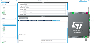

I starting new project than set some settings like system, timers, connectivity etc. Then I starting to set pins and... look at the picture. The cursor push TIM1 and nothing changes in the right window. In this point CubeMX do not work at all.
I tried this operation several times and result the same - CubeMX breaks own work day. And my heart too... I reinstalled the CubeMX too - nothing.
