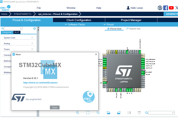

2024-09-19 11:45 AM
On https://www.st.com/en/development-tools/stm32cubemx.html#tools-software, the .1 version is not available for Mac, just windows and linux

Hello
I want to share the info that the installer for macOS is now available on st.com.
KR,
Semer.

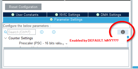

2024-10-04 9:38 AM
I don't know if this happened with v6.12 or 6.12.1, but there has been an annoying, no reason for this to change done to the UI. For the Parameter Settings tab the "Show/Hide description area" is enabled by default. If you turn it off and then go to another peripheral, and then back to the one you were originally looking at, it's back on!
Why was this done, and why is there no way to turn off this obnoxious behavior, and who thought this was a good idea?

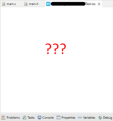

2024-11-18 7:59 AM - edited 2024-11-18 8:14 AM
What happened with CubeMX 6.12.1? It's empty... I tried to open my .ioc one time and nothing. So I tried to create the new one - nothing (I do some operations then it's even do not open throw the CubeMX). How to understand it and what to do? Which version is stable and I can use without bugs?
Windows 10 Enterprise 22H2 x64. I installed to new PC, tried to open old projects, tried to merge it, tried to create the new one. I saved .ioc to the old project it's worked. It happened throw the time. In general, such a simple application for some reason overloads the system or simply glitches on its own.
2024-11-18 8:14 AM
Looks like some local problems. Mine starts ok.
