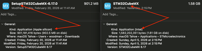

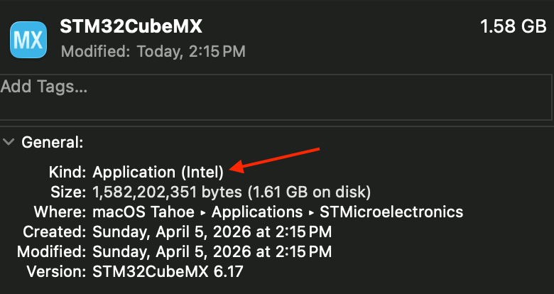

Downloaded the update of STM32CubeMX 6.17.0 to install the ARM version on my M4 MacBook Air with macOS Tahoe. The issue is that it installs an Intel version and not an ARM version. I uninstalled version 6.16 before installing this updated version.
The installer file was SetupSTM32CubeMX-6.17.0-Mac-ARM.app.tar downloaded from the STM32CubeMX download page.
The next macOS version after Tahoe will not support Intel apps and was expecting an Apple Silicon version as per the download!
What is up with this?

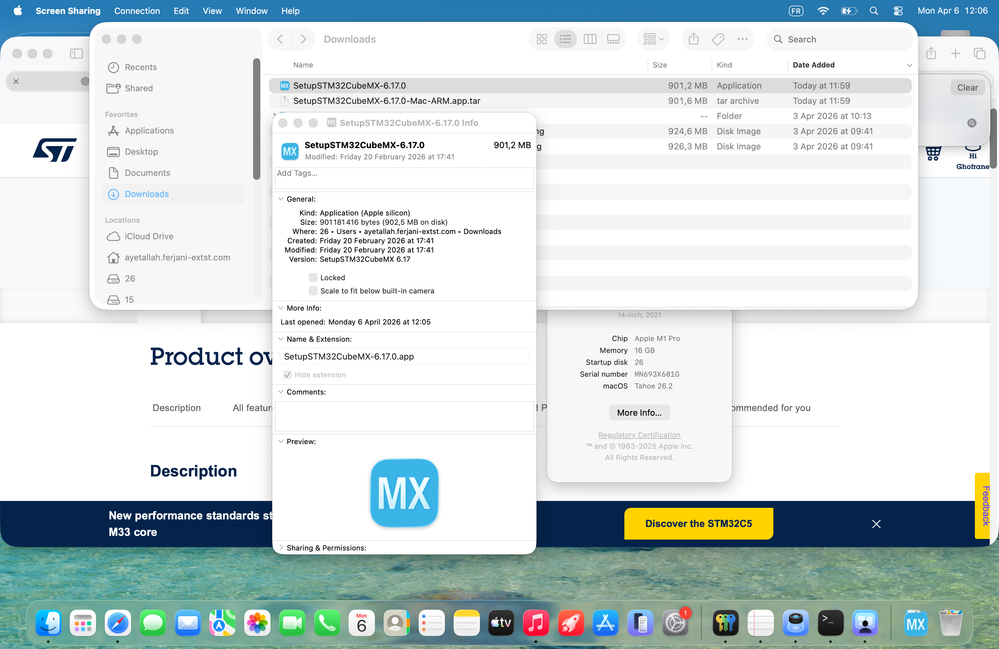

2026-04-05 11:03 PM - edited 2026-04-06 4:14 AM
Hello @woodmeister50
After running the test, I did not find any issues with SetupSTM32CubeMX-6.17.0-Mac-ARM.app.tar.
Thx
Ghofrane
2026-04-06 4:49 AM - edited 2026-04-06 4:53 AM
What you are showing is SetupSTM32CubeMX-6.17.0.
What I am saying and have shown is the actual resulting STMCubeMX app that is installed is an Intel app.
