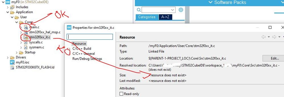

2020-08-03 12:26 AM
Startup folder available …. are linker scripts and .projet & .cproject available too or not ?
If yes maybe have you move your project location at a point ? Depending the way you're getting project alive some if source files are relying on linked resouces. If updating project env. without updating links may sounds like data lost.
Have a look to your resources small overlay icons ...

everything available except SRC folder,
i completed the project ,removed it from project explorer, i only noticing when l lookup the folder later to copy some code from it after some week
Final commit (before removing from project explorer) in git repository has SRC folder
problem i think is
i use same code base for different project because of same hardware board (copy it to different location and again import it and rename // or copy it inside project explorer and rename), so there is some trace of previous project location
2020-08-03 2:28 AM
Sounds definitively weird and not so easy to help you here as I guess we need much more details of your way of working.
Doing which action are your src data lost (only closed project opening or project import back or project update from .ioc editor or … ) ?
Are your projects rely on linked resources ?
