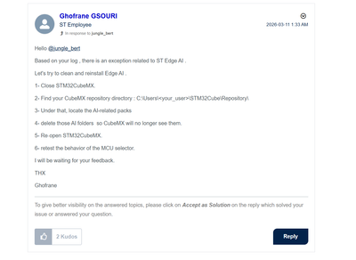

I had exactly the same issue and could be solved by removing xcubeai.
But it's confusing while reading this thread, another reply was marked as solution. Actually deleting .stm32cubemx/finder doesn't work.

Hello @XCTang
This solution has already been suggested in the following comment
