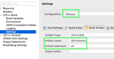

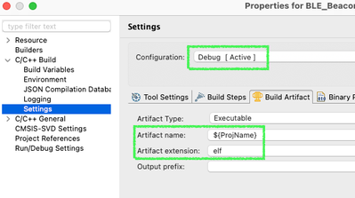

I don’t know how your STM32CubeIDE project is set up, but I guess it has multiple build configurations, likely Debug and Release, and both declare different output filenames. That is not supported at the moment.
Could you try to align them across your build configurations? Then try to convert again the project.
Note: the same applies to source files as well. All build configurations must use the same set of source files.

I changed the settings in the original Repository, as you said, but now i cannot go ahead with the converter on vscode since when I select the source project to convert in the plugin I get this error in vscode: "Entity expansion limit exceeded: 1002 > 1000". The error is in a small box on the bottom right. This happens only when I select the projet source and not for the destination.
