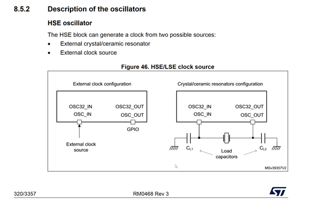

The manual RM0468 is clear:

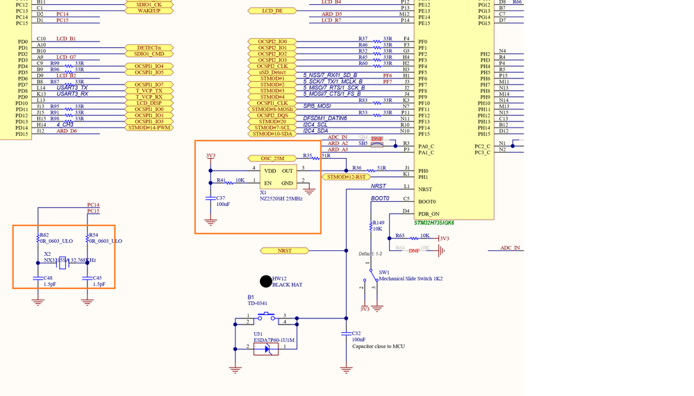

The schematic of the STM32H735G-DK kit:
X2 is a crystal, X1 is an oscillator:

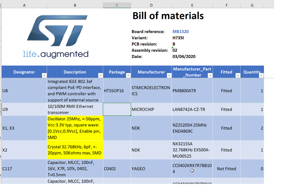

BOM says the same:

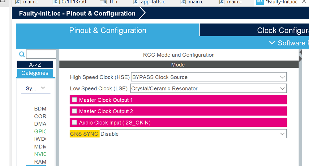

But STM32CubeIDE initialized as per the board:

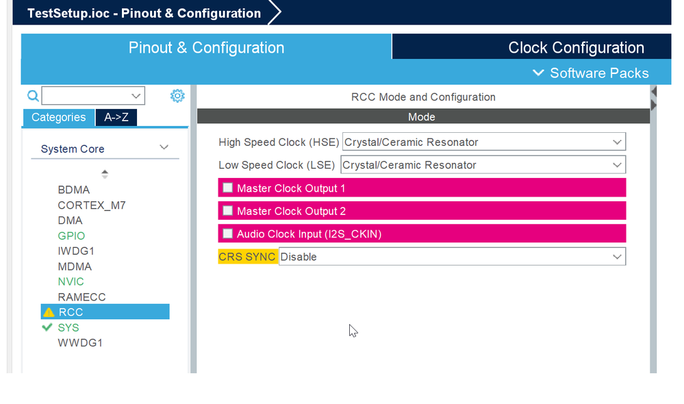

And should be: (IMHO)
My question: Is my analysis correct or did I overlook something?
