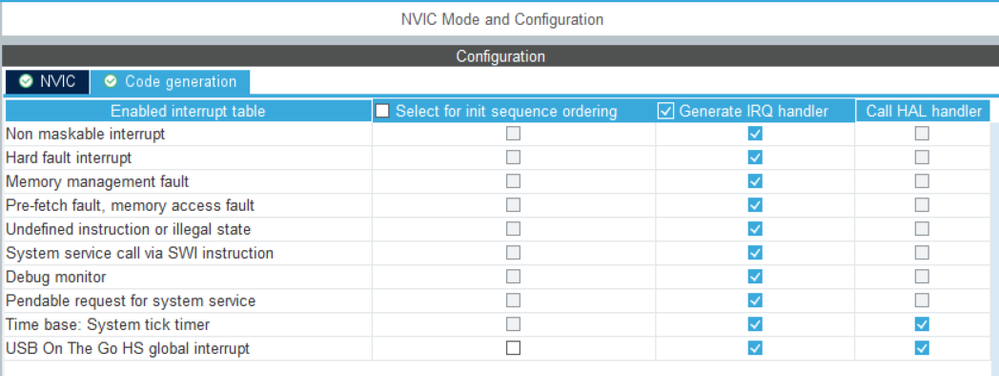

Please, check that interrupt for USB IP is activated.
I think this was an issue before.

Talking about the following interrupt "USB On The GO HS" here:

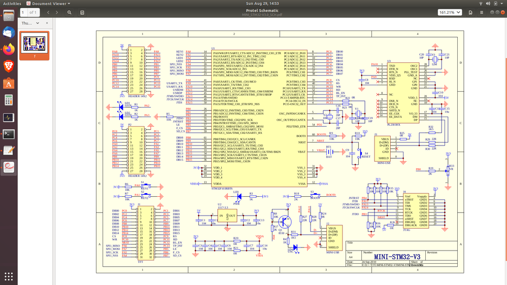

It is not even enumerating. The .hex file provided by the board manufacturer enumerates as USB HID, but when I create a project in STM32CubeIDE / STm32CubeMX, it does not even enumerate.

Do you manage PD2 in your software?
Where do you initialize PA11 and PA12 ?
Please look at usbd_conf.c from the STM32F103RB-Nucleo example

Hi Mike_ST,
I got it working on STM32F103RB, the PD2 was not set correctly. I am not able to get it working on STM32F429 and STM32F746 discovery board, WIP.
