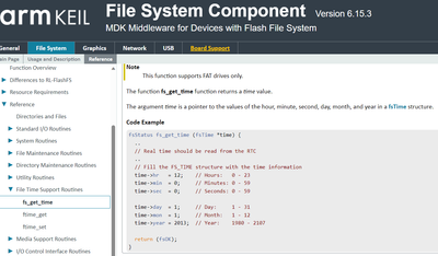

Seems like I need to do something like this for kiel5 to resolve the issue.

2023-11-07 5:32 PM
