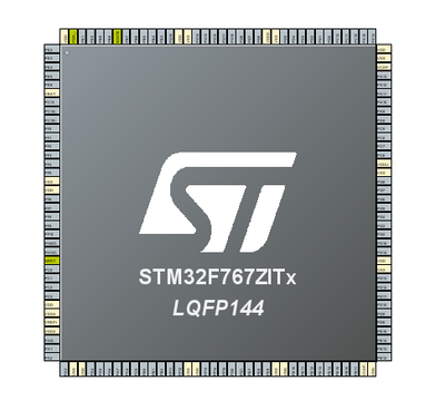

Using STM32CubeMX version 6.15.0
When I start a new project from the NUCLDO-F767ZI board I just get a blank chip, none of the component configuration at all, I tried it on two PC's both the same.
This used to work and was quite handy starting a new project. At the moment I am going through a selection of processors so having to manually configure it before I can test it is a bit of a pain, any solutions?

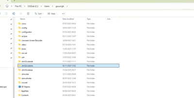

- Close STM32CubeMX.
- Delete the following folder .stm32cubemx (On Windows: C:\Users\<YourUsername>\.stm32cubemx)
- Restart CubeMX and try again
THX

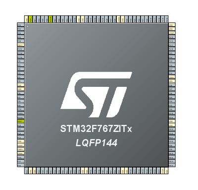

Thank you for getting back, I have been using that workaround for a while, the fact it also did it on my old PC that I use as a backup and have not been developing on led me to post on the forum.
So as you asked, I deleted that directory, re-opened CubeMX and started a project from the NUCLEO-F767ZI and
Same result on both my PC's?
I also tried other processors and tried to start a project from an example some do work but most do not? Very strange. This was working 2 days ago, I started a project with NUCLEO-F722 and today its not working.

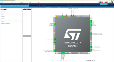

2025-11-12 4:47 PM
Just as @Ghofrane GSOURI , I am able to create a NUCLEO-F767ZI board project and have all the default peripherals initiated.
2025-11-12 11:56 PM
Hello @Rick Hamilton @Karl Yamashita
As requested @Karl Yamashita I am providing the IOC file along with a video recording of the steps I followed to create a new board project.
THX
Ghofrane
