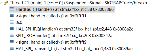

}But data isn't sended. And in debug mode i can see:

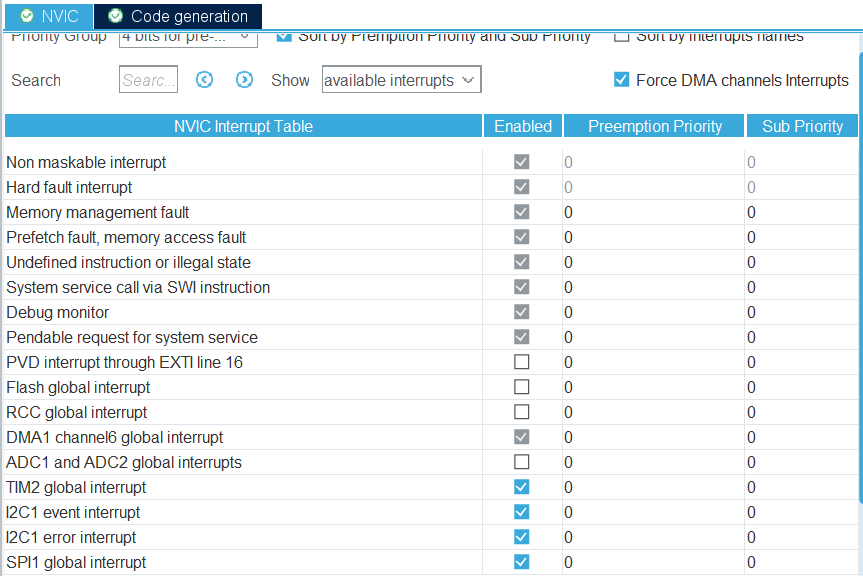

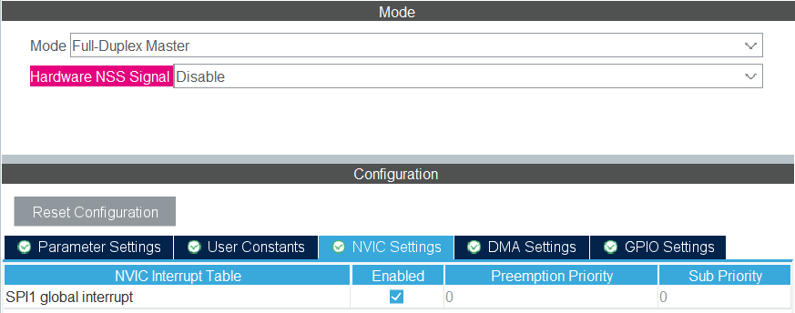

My project settings:
Other interrupt also not works.

2023-03-20 6:53 AM
Hi @EBurk.1 ,
looks like you didn't implement the callbacks correctly. The IRQ handler will use callback functions to notify your software about events, like for example buffer empty or buffer full. You need to implement these. Look at some examples from the intro pack repository to get inspiration.

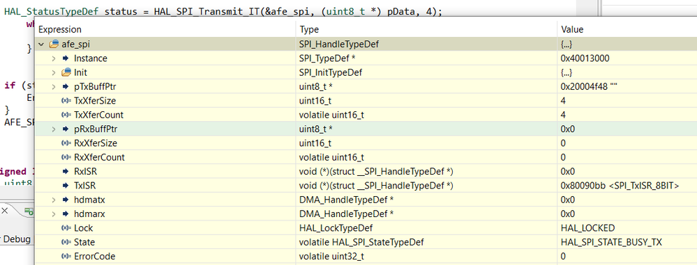

2023-03-20 8:02 AM
OK so how is hspi1 defined?
In debugger, look at where it is placed in memory, and what it its content, and show.

}2023-03-20 8:23 AM
I changed &afe_spi to &hspi1 and it works! I forget about pointer =0
Thanks to everybody
