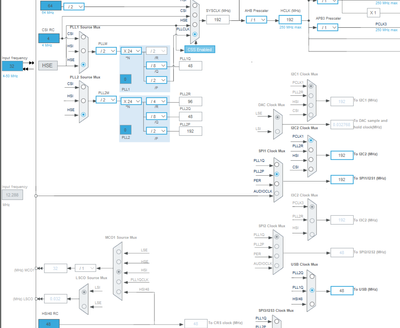

My intent was to use the PLL2Q source with the USB peripheral so I could also specify a 200MHz sys clock for everything else via PLL1. When I use the PLL2Q source however, I get no interrupts from the `USB_DRD_FS_IRQHandler` handler and so my USB stack does not operate.
To make things more confusing, it also does not work even when both PLL's have the same values set for all parameters, as shown in the image below.
It is important to note that this works with the PLL1Q source, as it is shown in the image, and I'm currently compromising a little on the sys clock speed. It will work for my purposes, but I'm more interested to know whether there's some "magic bullet" setting I'm missing, or if this could be a known configuration limitation.

For clarity, you said the configuration in the screenshot works, yes?
But if you change the radio button from PLL1Q to PLL2Q without changing anything else, it no longer works?

Yes, that's the confusing part: both PLLs based off the HSE with the same MHz configured, but with PLL2Q no interrupts are triggered whereas PLL1Q they are.
