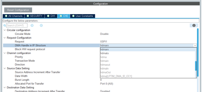

2025-09-17 1:39 AM
Hello @YoungKwan
Actually, you should modify the DMA Handle in IP Structure to hdmatx instead of hdmarx.

2025-09-17 1:39 AM
Hello @YoungKwan
