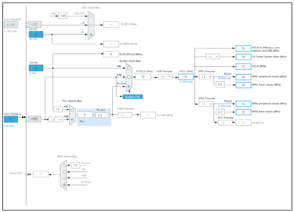

2019-09-13 6:27 AM
thanks, see attached my clock configuration. unfortunately I have no idea which parameters I must change for that. The external crystal is a 8.000 MHz.

2019-09-13 8:22 AM
Make sure a) the hardware actually clocks properly, get a scope and measure, output internal clocks via PA8 (MCO) pin, and b) that the setting of HSE_VALUE is coherent, ie HW and SW working from the same set of facts, so the computations will work correctly for the baud rate divider settings.
