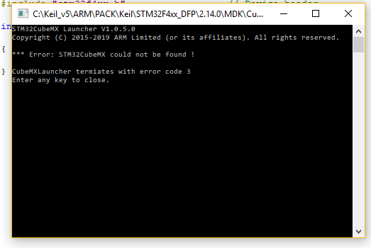

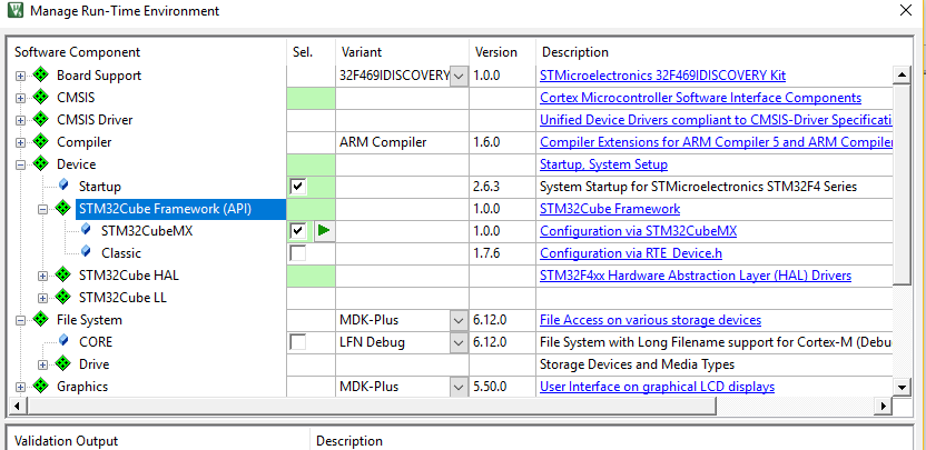

I tried to create a project but I couldn't. Please check out the images for understand the error
I selected STM32Cubemx on Manage Run
How to fix it?
