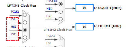

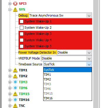

Hello, thank you for answers.
@Uwe Bonnes it seems that it is not possible to use LPTIM as system timebase source:
Also, it seems that the only sources I can use for LPTIM clocking are not precise ones...

I don't even know that ST sets that constant. Any way ARM suggests providing a default value, but you get to program whatever you want for the period, so the frequency of the CPU and if the ticker fires at 1 KHz or something else is entirely up to you.
The point with the LPTIM is you could use it or the RTC to provide the HAL timebase, you're not tied to SysTick. Even RTOS should be workable with a different periodic IRQ.

The tick interrupt could orchestrate the clock changes. LPTIM might be able to take a low frequency source. LSE can take up to 512 KHz as I recall.
