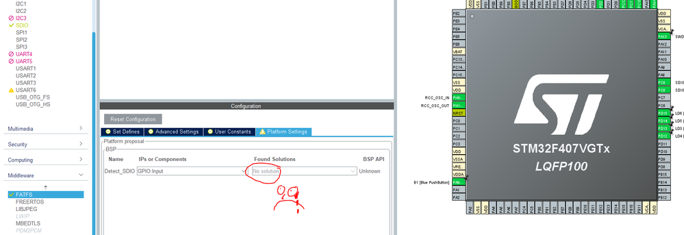

Im trying to follow this tutorial but inside platform settings of FATFS i get this:
No found solution for BSP api (SDIO detection pin?)

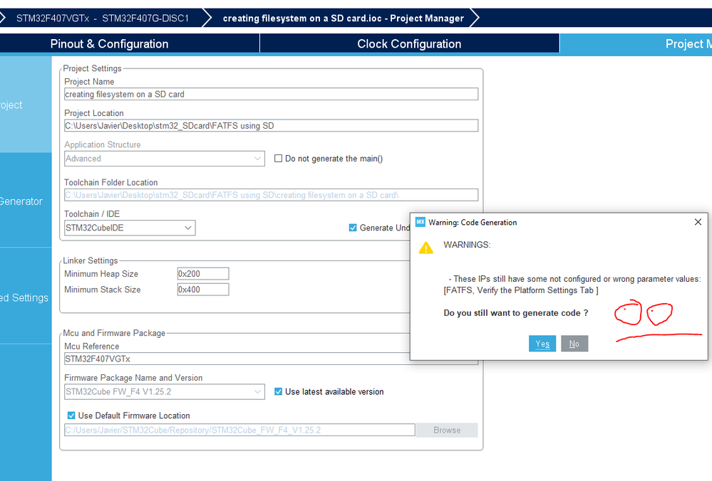

And when i press generate code i get this warning complaining about the very same thing

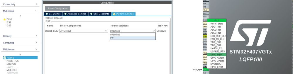

Hello @Javier Muñoz,
Thanks for your feedback. In order to correctly configure the Platform Settings for FATFS, a pin should be assigned to GPIO_Input.
Hereafter screenshot showing an example, where I configured PA1 on a STM32F407 as a GPIO_Input:

2021-05-10 2:49 PM
thanks @Khouloud OTHMAN !
this worked for me
