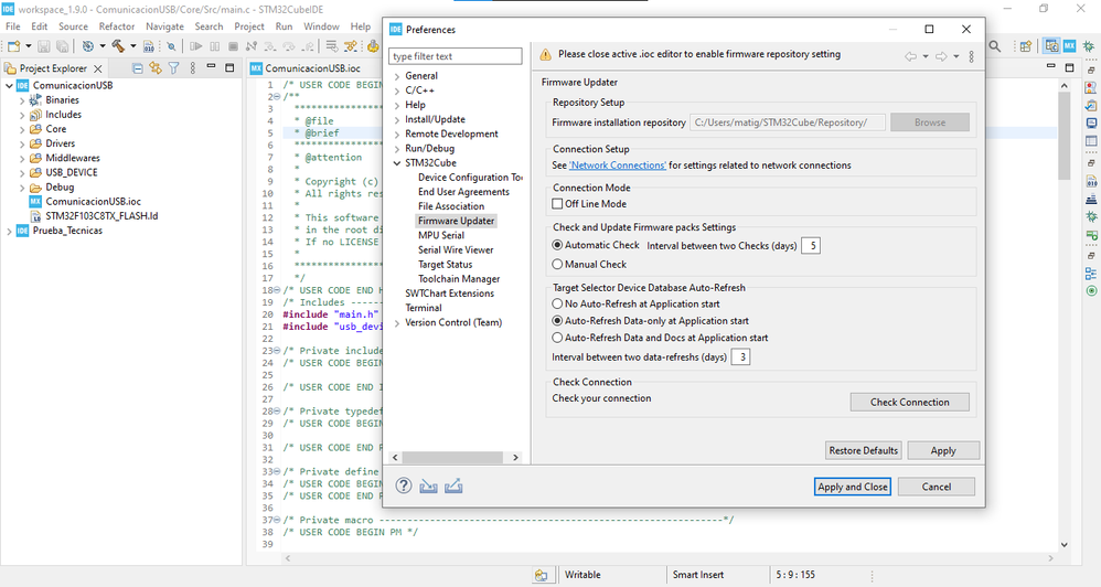

I had the same problem with CubeIDE 1.9.0. I was looking for the solution for several hours until I saw the suggestion of @IPaku.1 and finally I could solve the problem. In order to solve it I did the following:

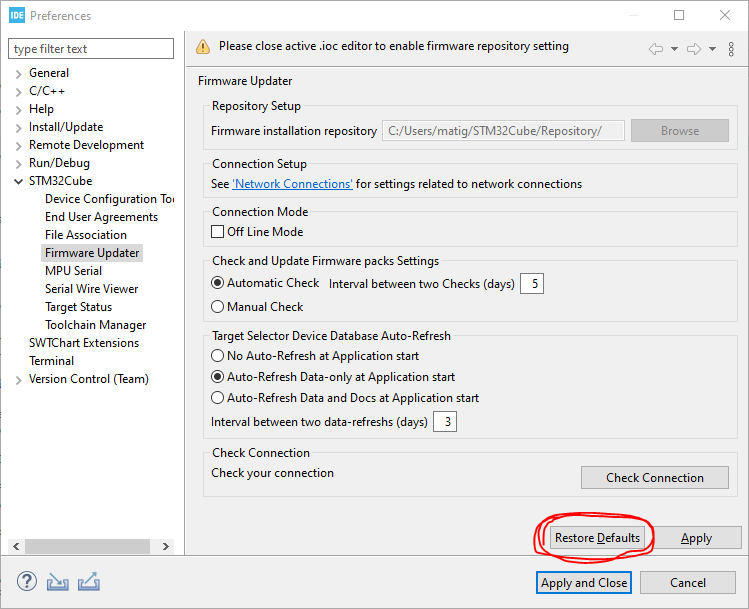

Inside the CubeIDE I went to "Window -> Preferences -> STM32Cube -> Firmware Updater"
If you have the same problem, it is probably because at some point you changed the address of "Firmware installation repository". I say this because when I had done that, the problem started.
The solution was click on "Restore Defaults" then "Apply and Close" and finally create a new project.
I hope you can solve it too. Good luck!
