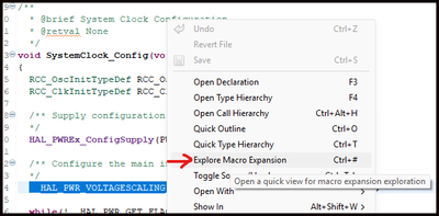

I can only see 1+2 in the macroexpansion. But clearly the IDE has calculated the value and can evaluate the #if ... #else and gray out the unused part. So how can i access this calculated value?
That's to be expected; that's what macro expansion does - it is purely text substitution.

That still just shows the macro expansion - it doesn't evaluate the result of the expression after expansion.
