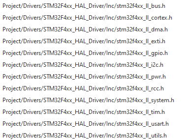

2022-07-06 8:06 AM
After this update, I also noticed the generator added several LL driver header files, even though I have only HAL drivers selected:
Build still works fine but I expect the files are added unintentionally.

2022-07-07 7:03 AM
Hello @ARaym.2 ,
Thanks for your feedback,
This is actually a normal behavior, it is new implementation done in MX v6.6.0.
Several users needs to switch between HAL and LL in their projects so starting from v6.6.0, MX copies both types of drivers whatever the settings to use HAL or LL for a given peripheral initialization.
Sara.
