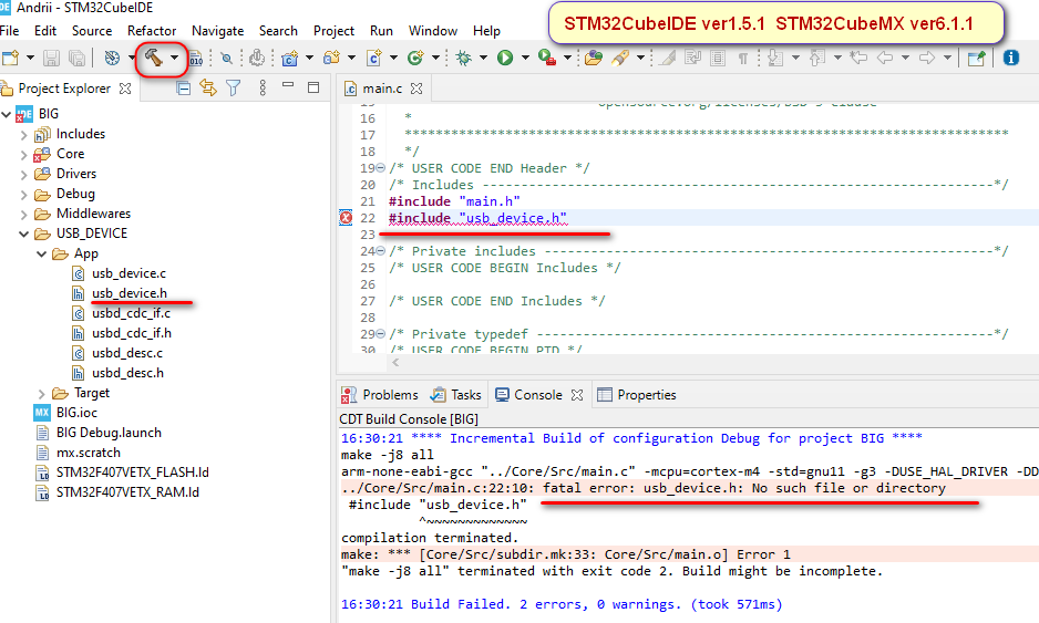

2021-01-16 5:00 AM
Before that there was STM32CubeIDE ver1.4.0 STM32CubeMX ver6.0.0 everything was fine.
Installed STM32CubeIDE ver1.5.1 and STM32CubeMX ver6.1.1, there was an error when connecting USB_DEVICE.
Tried creating a project from scratch with nothing but USB_DEVICE. Gives an error message.
What to do?

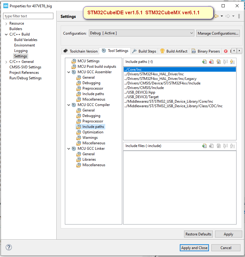

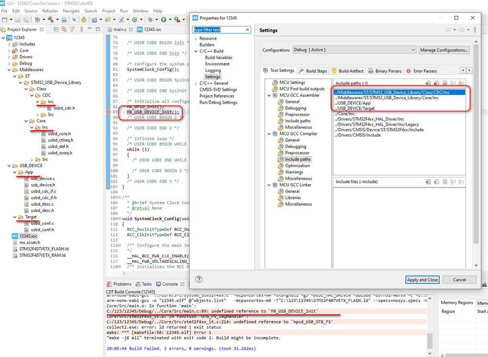

Check your include directories
Project properties -> C/C++ Build -> Setting -> Tool Settings -> MCU GCC Compiler -> Include Paths
2021-01-16 8:18 AM

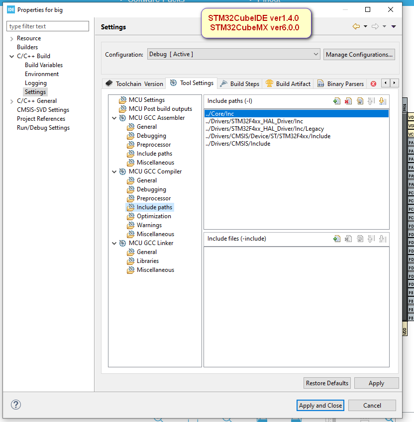

Added everything. It didn't get any easier. Error again!
I specifically looked at the settings on the old version. The settings on both the old and the new version are the same. But the new one doesn't work!

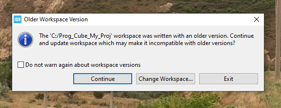

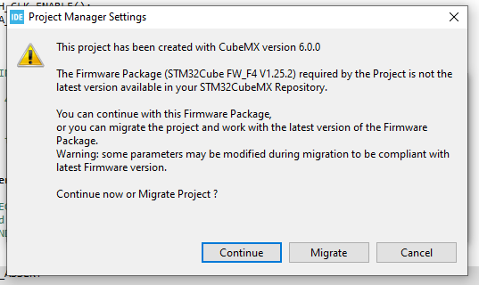

1) I'm launching a new version of STM32CubeIDE ver1.5.1 (STM32CubeMX ver6.1.1).
I indicate the directory with the old project on STM32CubeIDE ver1.4.0 STM32CubeMX ver6.0.0.
At startup it says: “The workspace was written with an older version. Continue and update workspace which may make it incompatible with older version? ".
I click Continue.
An older version message appears.
I click Continue.
The project opens and works as expected.

2021-01-22 3:12 AM
Did you manage to solve your problem?
I had something similar and I suspect the code generation to not go all the way to the end: in your project's screenshot there's an "mx.scratch" file leftover, which should disappear once the code is generated.
Then, CubeMX might not generate/include all the driver files such as your usb_device.h one.
I managed to get rid of it by re-doing all the project creation from the *.ioc file. It worked for some time but it happens again, and it's quite laborious to re-do everything...
