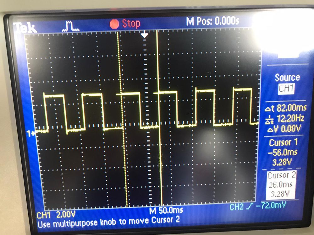

2020-05-27 5:11 AM
I look it with oscillscope. here is the view:

I played with prescaler and counter period values. When I tried with higher counter period such as 20000 etc. It gives correct frequency. But when I decrease counter period to 360. It starts to give wrong and higher frequencies. Might be the cause because of the capability of the MCU? Maybe it cannot produce PWM with that high frequency? (200 kHz)
PS: When I use prescaler:1 and counter period:199. Now it works. I guess we cannot use 0 in the prescaler..
2020-05-27 9:33 AM
Give numbers.
How exactly do you measure it?
Yes we can.
