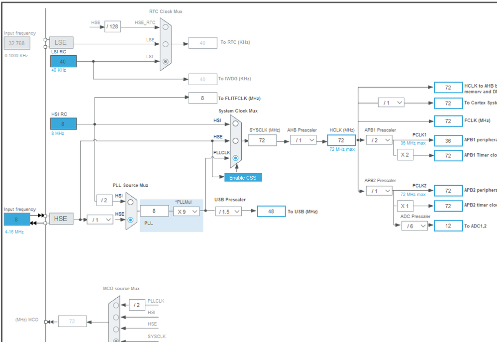

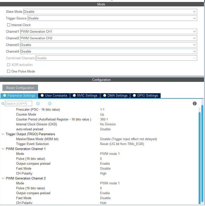

Now eventhough APB1 Timer Clock is 72 MHz. Prescaler is 0 and Counter Period is 359. The frequency of the PWM is 12 Hz. I use blue pill STM32. What might be the cause . I know it is a little bit irrelevant from the topic but I didn't want to open a new topic for that.
2020-05-27 4:50 AM
Please post the contents of the RCC and timer registers.
2020-05-27 5:02 AM
How do you know?
2020-05-27 5:04 AM
Here they are from CubeMX
RCC
Clock Config Screen
Timer 3
2020-05-27 5:10 AM
No, the contents of the hardware registers. Cube screenshots and and source code containing HAL function calls are useless for troubleshooting.
