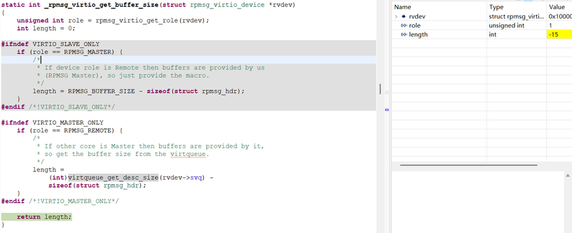

Hello, 745_AMP is configured using CUBEIDE1.16.0 and the code is running normally. AMP_745 is configured with CUBEIDE1.18.0 and the code runs abnormally. CUBEIDE 1.16.0 uses the firmware FW_1.11.0 of H7, while CUBEIDE 1.18.0 uses the latest firmware. After you successfully submit the bug, I will set the answer you successfully submitted as the best response. I will include my debugging information and error code at the end of the article.
static int rpmsg_virtio_send_offchannel_raw(struct rpmsg_device *rdev,
uint32_t src, uint32_t dst,
const void *data,
int size, int wait)
struct rpmsg_virtio_device *rvdev;
struct rpmsg_hdr rp_hdr;
void *buffer = NULL;
unsigned short idx;
int tick_count = 0;
unsigned long buff_len;
int status;
struct metal_io_region *io;
/* Get the associated remote device for channel. */
rvdev = metal_container_of(rdev, struct rpmsg_virtio_device, rdev);
status = rpmsg_virtio_get_status(rvdev);
/* Validate device state */
if (!(status & VIRTIO_CONFIG_STATUS_DRIVER_OK)) {
return RPMSG_ERR_DEV_STATE;
if (wait)
tick_count = RPMSG_TICK_COUNT / RPMSG_TICKS_PER_INTERVAL;
else
tick_count = 0;
while (1) {
int avail_size;
/* Lock the device to enable exclusive access to virtqueues */
metal_mutex_acquire(&rdev->lock);
avail_size = _rpmsg_virtio_get_buffer_size(rvdev);
if (size <= avail_size)
buffer = rpmsg_virtio_get_tx_buffer(rvdev, &buff_len,
&idx);
metal_mutex_release(&rdev->lock);
if (buffer || !tick_count)
break;
if (avail_size != 0)
return RPMSG_ERR_BUFF_SIZE;<-------The problem lies here
metal_sleep_usec(RPMSG_TICKS_PER_INTERVAL);
tick_count--;
if (!buffer)
return RPMSG_ERR_NO_BUFF;

Hello @MECHO ,
In fact the issue has been already reported in this post.
In fact in your non-working project, you have this warning:
<command-line>: warning: "RPMSG_BUFFER_SIZE" redefined
<command-line>: note: this is the location of the previous definition
So in conclusion:
You have two issues from the beginning:
- You didn't update the linker files to allocate memory for OpenAMP.
- An issue with the generated code with STM32CuebIDE 1.18.0 (a regression from older versions)
