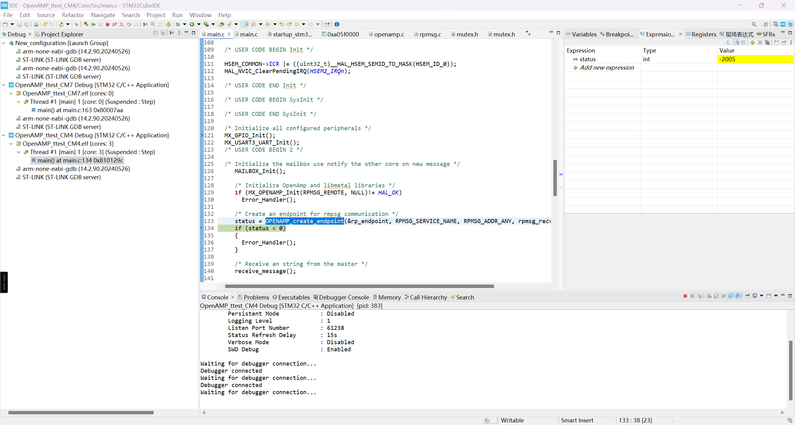

The problem is as follows: when using this chip for dual core communication, reproducing according to the example given by ST, communication cannot be carried out no matter what.
Through debugging, it was found that the problem lies in the OPENAMP_create_endpoint() function in the M4 core. The return value is -2005, but as a beginner, I am unable to pinpoint where the problem lies. I will attach my project at the end of the article.
My original goal was for the M7 core to send data to the M4 core, which would then print the data while the M7 core's LED would flash.
I have reviewed the corresponding routines in ST's AN5617 and firmware, and watched the corresponding videos, but still cannot solve the problem. I request your help

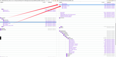

Look for example at the linker files in the example: Projects\STM32H747I-EVAL\Applications\OpenAMP\OpenAMP_PingPong\

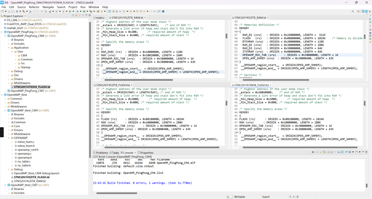

Please review the linker files OpenAMP_ttest\CM7\STM32H745ZITX_RAM.ld and OpenAMP_ttest\CM4\STM32H745ZITX_RAM.ld
This is what you have in your linker files:
For CM7:
MEMORY
RAM_D1 (xrw) : ORIGIN = 0x24000000, LENGTH = 512K
FLASH (rx) : ORIGIN = 0x08000000, LENGTH = 1024K /* Memory is divided. Actual start is 0x8000000 and actual length is 2048K */
DTCMRAM (xrw) : ORIGIN = 0x20000000, LENGTH = 128K
RAM_D2 (xrw) : ORIGIN = 0x30000000, LENGTH = 288K
RAM_D3 (xrw) : ORIGIN = 0x38000000, LENGTH = 64K
ITCMRAM (xrw) : ORIGIN = 0x00000000, LENGTH = 64K
For CM4:
MEMORY
RAM_EXEC (rx) : ORIGIN = 0x10000000, LENGTH = 128K
RAM (xrw) : ORIGIN = 0x10020000, LENGTH = 160K
And look at what I shared previously as linker files content.
You have this is missing:
OPENAMP_RSC_TAB (xrw) : ORIGIN = 0x38000000, LENGTH = 1K
OPEN_AMP_SHMEM (xrw) : ORIGIN = 0x38000400, LENGTH = 63K
__OPENAMP_region_start__ = ORIGIN(OPEN_AMP_SHMEM);
__OPENAMP_region_end__ = ORIGIN(OPEN_AMP_SHMEM) + LENGTH(OPEN_AMP_SHMEM)
And forget about the files location as they are not the source of the issue.

2025-04-16 8:59 AM
First, please use </> button to share you code. Please read this post.
Second, please remove this memory region declaration at 0x38000000:
as it's already used by:

这是我的 M4 和 M7 内核的主要功能、闪存和 RAM
M4(FLASH.ld)
/* Entry Point */
ENTRY(Reset_Handler)
/* Highest address of the user mode stack */
_estack = ORIGIN(RAM) + LENGTH(RAM); /* end of RAM */
/* Generate a link error if heap and stack don't fit into RAM */
_Min_Heap_Size = 0x1000; /* required amount of heap */
_Min_Stack_Size = 0x800; /* required amount of stack */
/* Specify the memory areas */
MEMORY
FLASH (rx) : ORIGIN = 0x08100000, LENGTH = 1024K
RAM (xrw) : ORIGIN = 0x10000000, LENGTH = 288K
__OPENAMP_region_end__ = ORIGIN(OPEN_AMP_SHMEM) + LENGTH(OPEN_AMP_SHMEM);
M4(RAM.ld)
/* Entry Point */
_Min_Heap_Size = 0x200; /* required amount of heap */
_Min_Stack_Size = 0x400; /* required amount of stack */
MEMORY
M7(FLASH.ld)
MEMORY
FLASH (rx) : ORIGIN = 0x08000000, LENGTH = 1024K /* Memory is divided. Actual start is 0x08000000 and actual length is 2048K */
M7(RAM.ld)
/* Entry Point */
_estack = ORIGIN(RAM_D1) + LENGTH(RAM_D1); /* end of "RAM_D1" Ram type memory */
/* Memories definition */
MEMORY
