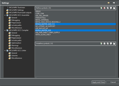

So there is a wrong (re)definition of RPMSG_BUFFER_SIZE in the project settings. A temporary solution is to remove it from the project settings for both cores and recompile.

2025-04-21 3:12 AM - edited 2025-04-21 6:12 AM
Regards,
Chris
2025-04-21 5:31 AM - edited 2025-04-21 5:31 AM
Hi Chris,
Thank you for your explanation. The issue has been resolved.
